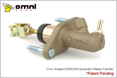

Track proven to reduce road circuit and 1/4 mile times.
-Restores harmonious synchronization to clutch pedal and short shifter
-Increases stock clutch performance and works with all aftermarket clutches
-Greatly reduces mis-shifting
-Hassle free 2 year warranty
-OEM replacement for worn out stock clutch master cylinders
-Improves clutch pedal feel
-Allows sequential like shifting
-More relaxed and natural shifting technique
-Crisper more defined clutch engagement
Estimate Price=$496
